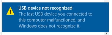

Hey
I recently updated my OPO to CPS13 and ever since the update I am unable to connect it to any PC. I have enabled USB Debugging and changed USB configuration to MTP in Developer Options but still Windows doesn't recognise it. It says "The last USB device you connected to this computer malfunctioned, and Windows can not recognize it." In Device Manager it says Device Descriptor Failed and gives Error 43.
Any idea how to solve this problem?

Hello all,
I face the same issue of not able to connect the phone to pc via USB.. with the cable provided with OnePlus One, the device drives are not getting installed automatically. I have tried enabling the developer options for Android debugging, still no luck. I am using Win 10. Please help. :(
P.S. attached is the Screenshot of the error given in windows while i try to connect. (tried all ports different Oneplus cables too).
Error message:
Windows has stopped this device because it has reported problems. (Code 43)
A request for the USB device descriptor failed.
Thanks for the reply Bro. Got it fixed - had to navigate to 'Settings --> Storage', tap on 'three dots' on the top right, enable 'USB Computer Connection' and select 'MTP' or 'Camera' as the transfer mode. :)
