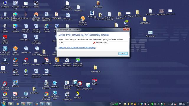

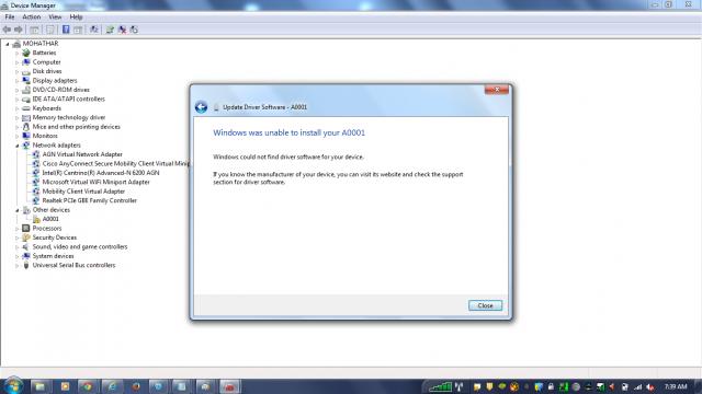

Thanks for your reply Kolio. It seems Windows is not able to find driver software for OnePlus One. I have attached Screenshots. Kindly assist in getting the corresponding drivers installed so that I can use OPO on My Laptop. Thanks.
This Should work:
https://developer.android.com/sdk/win-usb.html
Again,please keep us posted on your results.
