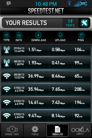

PM me and I'll tell you how I did it I did not know where to post it I'm some kind of freaked out it's so fast

No spoof goto es file explorer
Set root privilege goto device/data/system find throttle folder and usage stats delete everything in those two folders then change the permissions for both folders to read and execute only Walla that's how I did it
Don't know why you would think I faked it I was just revealing how I did it so maybe someone else could do it too I could care less if you don't believe me I don't know how long it'll last before Boost Mobile catches on but anyway give it a try
I read a few things on the web about how the carriers can only really throttle you if they have access to your system files someone needs to figure out a way to block them from changing your file system
that throttle folder does nothing these days. its all server side that they throttle you.
and why do i say its spoofed? because you are on a 3g only phone claiming to get speeds comparable to verizon LTE. sprints evdo rev a is capable of maxing out under PEAK conditions at 3.1mbps.

im on my porch and that is my local sprint/att tower and i get 1.2mbps on 3g.
