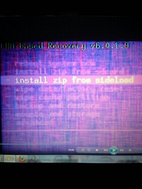

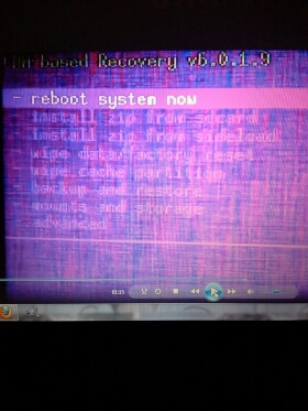

How's that phrase go? If you build it, they will come. Still no boot options BUT, so far IT WORKS! The prettiest recovery I've ever seen. PROPS TO YA BRO! Still a few hiccups.
No boot options.
Device boots to "Factory Mode". I changed the /EFS/FACTORY APP/factorymode file to "off", we'll see what happens.
Custom Binary counter is on. XDA has a thread to get rid of that.
Can't partition the extSdCard.
Check the pic, problems with partitions being unsafe? EFS?

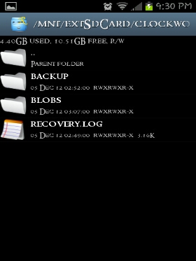

I made a backup, took forever, haven't gone any further.
