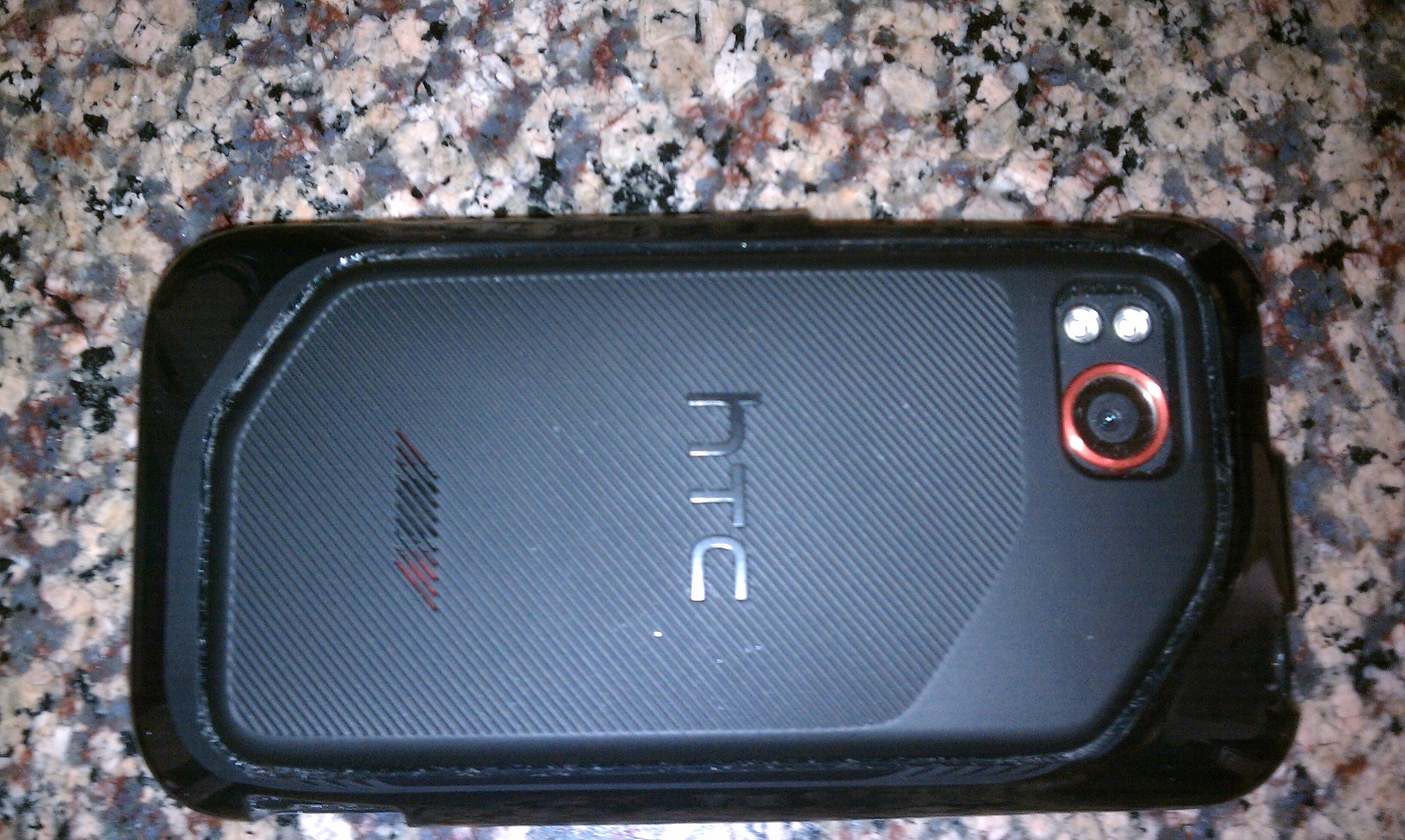

I was streaming netflix in 4g for 30 minutes. The battery got to 129F. The next day i was streaming netflix for 1 hour in 3g and the battery got to 131F. I have an extended battery with a case with the battery space cut out. When i plugged it in I got the flashing green flashing Amber led. How hot is too hot? Should I be able to stream a whole movie (2 hours in 4g)? The phone worked fine. It was warm. But, it did not shut down or anything like that. How hot is too hot?
When it starts getting close to 140F that's pretty hot. My battery has never gotten above 112F (at least during those times I actually checked). Streaming netflix for 30 shouldn't get your phone that hot. I'll do my my own test later just to compare and give you some feedback. However, I don't use a case with my phone.

What do you think about the heat issues and the case with the battery space cut out? Do you think streaming in Normal mode (3G and using 40% brightness) instead of High Performance (4G and max brightness) would be better for not building up as much heat? Or just go without a case when I stream media?
