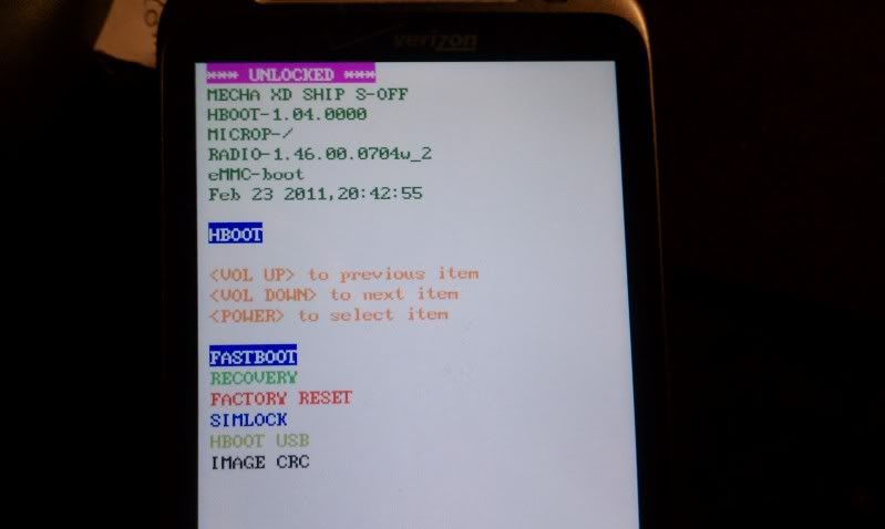

again,no real benefits yet,but thot id give it a shot,if for no ohter reason to test and give feedback to the dev,if needed:
please note that the version is indeed the shipping 1.04.0000,and not the engineering 1.04.2000.
i used it to flash jcases kanged clockwork,and flash back to the 627 radios for some testing. worked fine. :)
also made sure its seen in fastboot,and typing "fastboot oem ?" brings up what looks to be an identicle list of available commands.
ill prolly leave it a few days and change it back. working fine but i dont like the pink "unlocked" or the "ship s-off"... it was much sexier when it just said "eng s-off" :D
