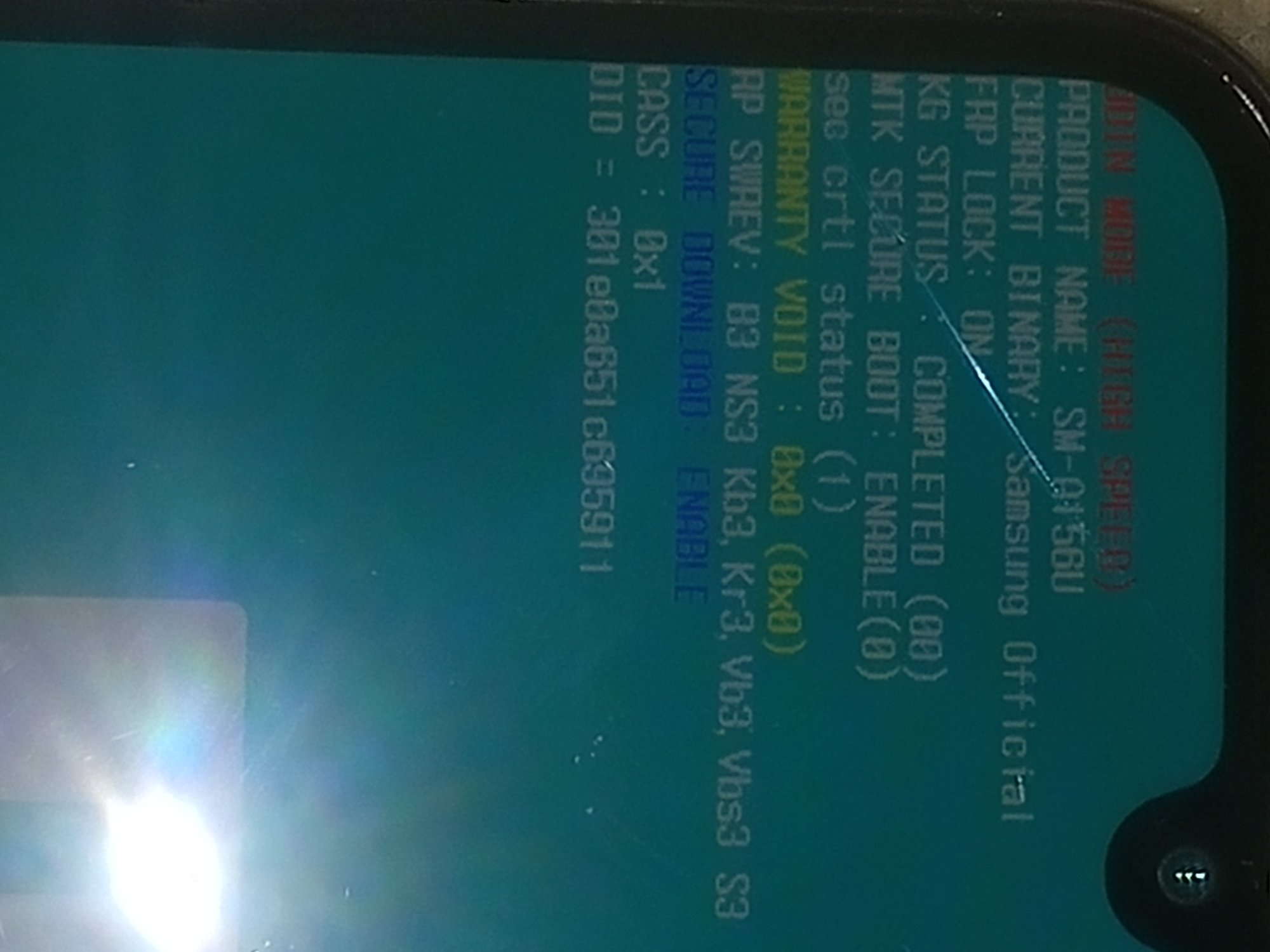

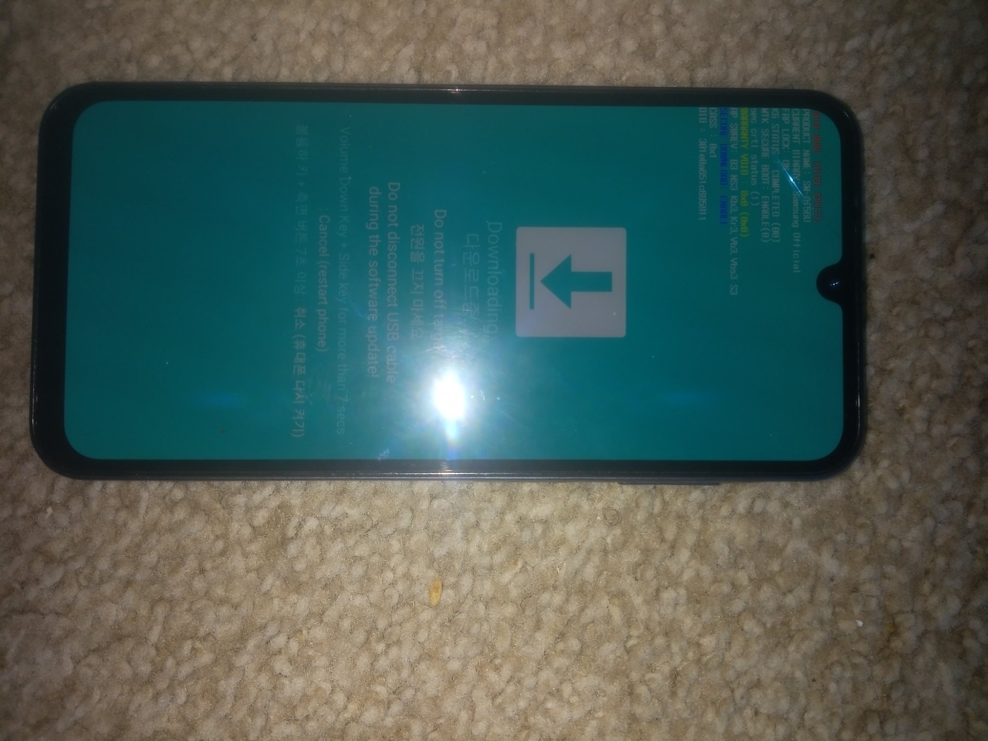

I have been asked to fix a phone. The problem is I don't know what to do about it. It's stuck on a bluish green screen. Could this be malware? I will try to post a few photos.

It's ok now. I just did the hold 'em both for 7 seconds trick and it turned out fine. It sure looked evil, though. His phone is a plain box stock Samsung that he got with a carrier plan. He doesn't like it much but he doesn't know how to adjust screen brightness or text, which means he's probably stuck with it as is.
both screenshot show some form of the download mode from samsung.....which is one way you can use to update the phone..... nothing nefarious about it.

just an fyi malware would not do something like that. malware is designed to be either undetected to steal personal data or to flood your phone with adware. it can also be used to let others gain access to your phone, but again usually hackers want to not be noticed or found.
so when you see something like what your friend has, just know that it is probably not malware.....especially if it says download mode or in case with samsung phones, odin mode. odin is a utility program that samsung used to use and is exclusive to only samsung phones.
