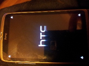

ciao....mi dovete scusare ....ho un problema il cellulare non si accende col volume (-) si accende solo con lo start sopra ,,,,, ho provato a fare vari combinazioni ma niente si accende solo col pulsante start e mi appare una schermata nera con scritta HTC in mezzo e 4 triangoli nei lato.....ho sbagliato qualcosa ????
Black screen with 4 triangles is something that happens when an RUU fails.

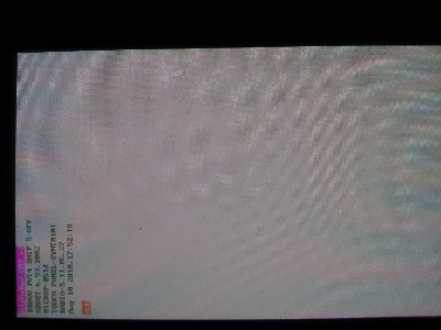

Have you managed to change the hboot? If not, try this:
* Download this file: alpharev.nl/PB99IMG_stock.zip. Rename it PB99IMG.zip and copy it to your sd card (replacing any other file with that name). Boot the phone to the hboot screen - the one that says:
AlphaRev CM7 r2
BRAVO PVT4 SHIP S-OFF
HBOOT-6.93.1002
The phone should ask whether you want to apply the update, then say yes. This is the same as how you tried to apply the RUU update.
If that works, reboot the phone, then try the RUU again.
If it doesn't let you update this way you'll need to use fastboot on a computer to fix this. Let us know if that's the case.

Do those images mean that the hboot would not run the PB99IMG.zip? If you have not tried that, try it first.
If it will not work, then you need to install "fastboot" on your computer. If you use Windows, there are some instructions here: http://androidforums.com/desire-all-things-root/337356-faq-adb-fastboot-windows-updated-1st-june-2011-a.html#%E2%80%9D2%E2%80%9D
Then download the bravo_stock hboot image: bravo_alphaspl.img.
Then connect your phone to the computer using usb, and use the command "fastboot flash hboot bravo_alphaspl.img" to install the hboot image.
Once that is done, reboot the phone. Then download the RUU you want to use as a Windows .exe file (not a PB99IMG.zip), connect the phone to a PC via usb and run the RUU .exe. That should fix it. Which RUU do you need (what network, for example)?
