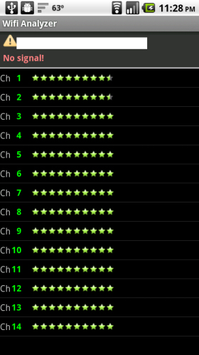

Hey all,
I can't for the life of me figure out why my wifi will not stay connected after the Froyo update 2.2. A few things (to get them out of the way): yes, I'm fully updated (all apps are 2.2 compatible), running FRG22D, Wifi is on, I've tried turning Airplane Mode off then on which doesnt' seem to improve anything either, and all router settings are pretty basic and thoroughly checked. Oh - on my other phone (HTC Incredible), the wifi will stay on consistently - both using the same network & settings, sitting next to each other 3 feet away from router.
Attached are screenshots from Wifi Analyzer showing how frequently / consistently I drop my network connection. I particularly like the shots that look like combs! It should be a straight bar going across the screen... Sometimes when running apps, it's not noticeable. However, when running something like TV.com, YouTube, or even web browsing, I lose connection completely. Ugh...
Any suggestions? I think I'm gonna hard reset the phone - any reason not to? I really hate resetting up my phone the way I like it. It's just tedious...
Also, I'd like to mention that I didn't have this problem before the 2.2 update, which is the only thing that has changed when the problem began. So isn't this the problem??? Why do I have to figure out the resolution to Droid's problem?? (You don't need to really answer that last question! LOL)
Thanks for your help...

I think the comb shape is due to the SSID being hidden. When I broadcast my SSID, my wifi analyzer changes from the spikes to a smooth signal. I've been having connection problems, too, and have come to think that the spiked pattern doesn't contribute to my issue. Yours may be different.
The sawtooth pattern seems to be a problem with the way the new version of wifi analyzer handles blocked SSID's. My connection seemed solid even though wifi analyzer was sawtoothing like crazy with SSID blocked, straight line when I reset to SSID broadcast.
FOLLOWUP: On a SSID-blocked WPA(1)-PSK TKIP "g" network feeding a DSL connection, I see an amazing spiked pattern on wifi analyzer, and the Droid telling me I have a weak signal. HOWEVER, Speedtest.net shows a speed of 2.6mbps down, 801kbps up, which is hardly indicative of a bad connection. So, whatever is going on (all since the 2.2 update) is really really weird.
I'll give it a try to see if it makes any difference, but in my neighborhood, I don't like to broadcast my SSID all over the place. Not willingly anyway.
Allanlaw - I'm not sure about this. Maybe though. On my HTC incredible, the connection is nothing like this - just a straight line (at about -65 dB), with a few drop outs. No big deal, and it has a really strong, consistent connection. No problems on the HTC Incredible. On the Moto Droid - sawtooth pattern as before. Resetting the phone did very little, if anything. I get the same results on Speedtest for HTC Incredible. I haven't thought of doing that on the Moto Droid, will try that tonight to compare.

Another data point - using the network that I described above. I changed the router from using a fixed channel (6) to auto-select. With SSID off, and the router deciding to go to channel 1, the DROID would not connect, no matter how many times I tried to manually connect. Changed back to a fixed channel, and all was well. So, give that a try if you are on auto-select.
That's a good point, allan. I always used to be on a 'auto-select' and it would put me at channel 6. Looking at wifinder, I've noticed that ch6 is pretty crowded, and upper numbers were not. So I switched to a fixed ch11, and still seems to be the same, although just consistent now.
Thx
I had the same problem described on my Droix X running 2.2. Our router was configured to auto sellect the channel. I tried selecting channel 1, but the problem continued. Switching to Channel 6 seems to have solved the problem.
