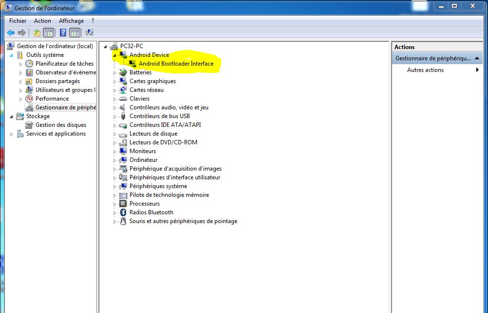

It shows "Android bootloader interface" >> see picture.

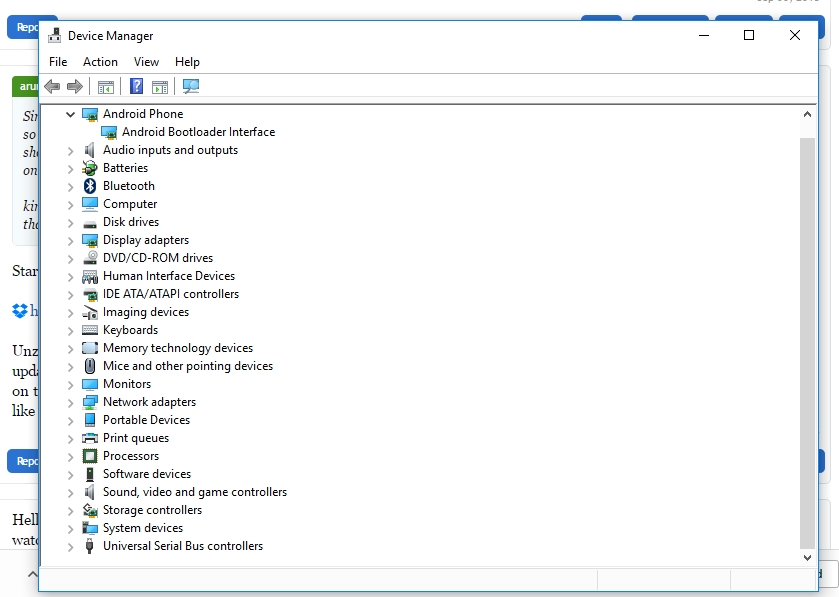

Hello Sir ! Plz help me i have the same issue i install wrong firmware now no download mode my phone is in fastboot mode and same commands are showing and device manger shows "Android bootloader interface '' .Moreover i have installed qualcomm driver but it doesn't show see the pic So please tell me solution one by one step i will perform
sorry for bad english.

Ok so you have no choice but to short the capacitors. If you continue to get 9008 mode,
follow the picture instructions here:
http://forum.xda-developers.com/lg-g2/general/fix-unbrick-lg-g2-stuck-qualcomm-hs-usb-t2933830
However don't use the board diag tool posted there. Instead use this one:
https://mega.co.nz/#!pZQyXbAD!960ZDwH36ZwqY2C7CoiDdfgxCRodU2VPFMaAGkobtCc
Use the .exe inside 3.99c variant 2.
