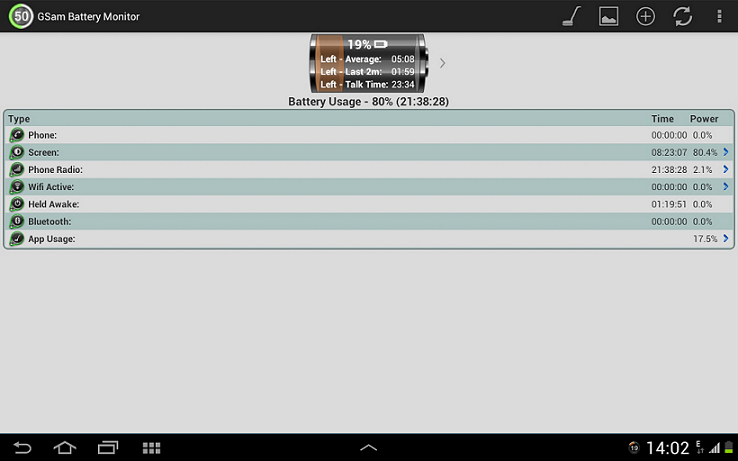

What you should look at is what is using the battery. First of all start with something like GSAM Battery Monitor.

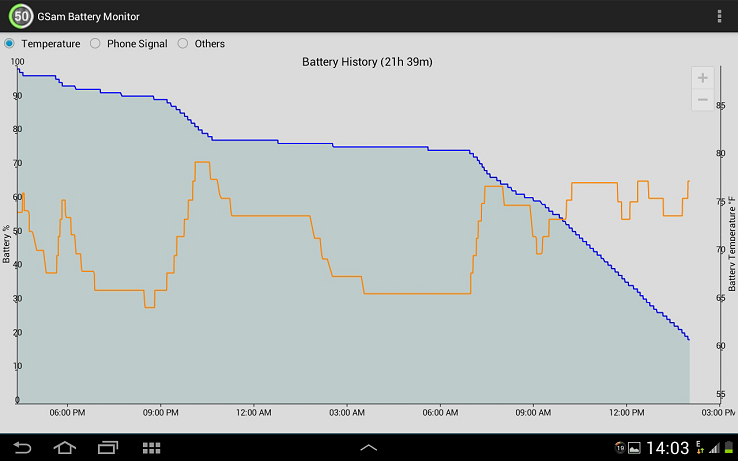

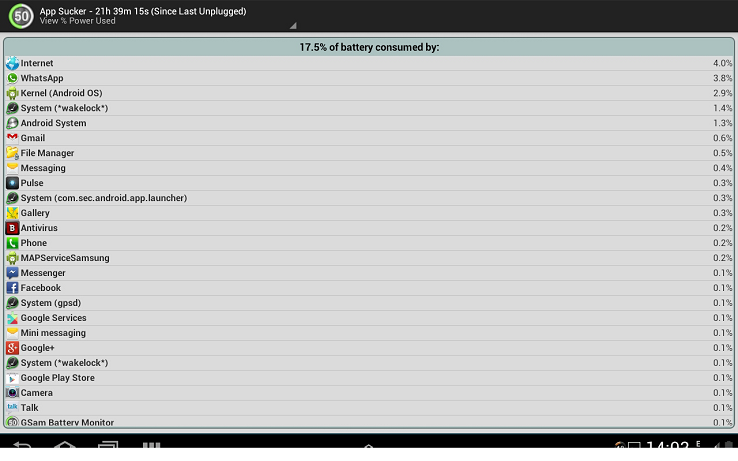

Thanks for your reply. I have added screenshots from the GSAM Battery Monitor (free version), which I just installed a few minutes ago.
What do you think?

Screen on for over 8 hours. You are not going to get much more than that. Lower brightness and turn features on that will make screen use less energy.
With screen-on, you are not going to get much more than 10 hours.
