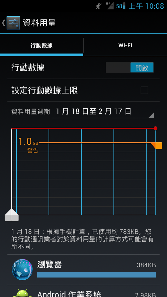

Hi guys, we got true working recovery now. I try to port some roms as expiriments of learning custom roms building when I am free. To start with, I found that we can port from devices that share similar specs. Examples are: Sony Xperia V (Tsubasa), Moto Droid Razr M (xt905,xt925), Lg Optimus Vu2 and Optimus F7 (fx1s) and more.
Here are what I came up with. CM10 is quite light and similar to aosp

The phone seems to run faster on cm10 than stock rom lol. I found that it is not fully working. Camera, wifi & nfc do not work though
The phone seems to run faster on cm10 than stock rom lol. I found that it is not fully working. Camera, wifi, nfc & proximity sensor do not work though

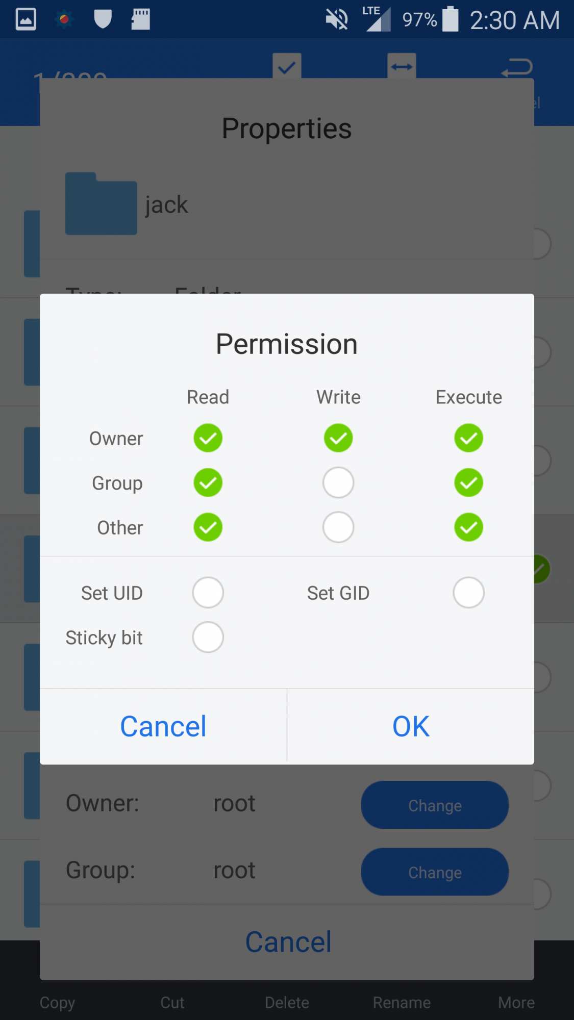

Did youvsetbthe proper permissions (lib)?
Just a thought but changing you buildprop. to mimic the device that cm was intended for might be worth a try. I wouldn't get my hopes up but you never know.
Yes, I used the updater script from the port rom. I hv tried to change wifi section of my cm build.prop but with no luck

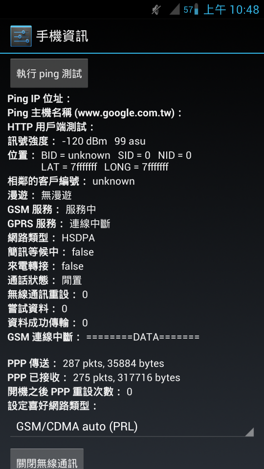

Hi, after all, I noticed the wifi unusable problem is due to wpa-supplicant has not initialized shown in the testing menu. (dial *#*#4636#*#* in phone) Any ideas?
