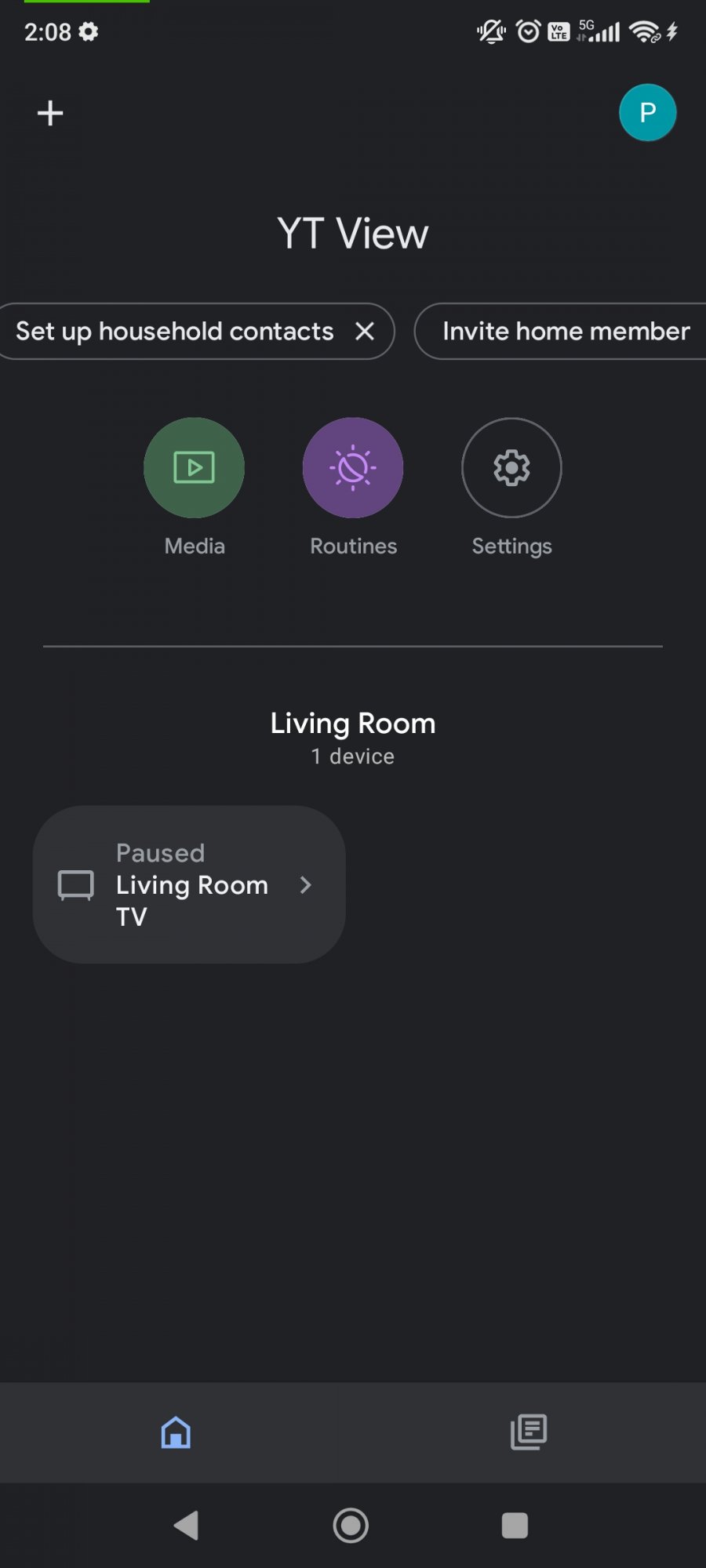

I can confirm that I can fully use my Chromecast 2 with a single smartphone, a high spec 2020 model Poco F2 Pro.
There's hardly any difference between the Chromecast 2 and Chromecast 3:
https://smarthomestarter.com/how-to-connect-chromecast-to-mobile-hotspot/
I have screenshots and photos of my 2012 Panasonic Plasma TV without wifi (it was an optional dongle).
The Chromecast is tethered to the Hotspot connection on my phone. I don't need a second device on the same WiFi to control the Home app, You Tube, photos etc.
