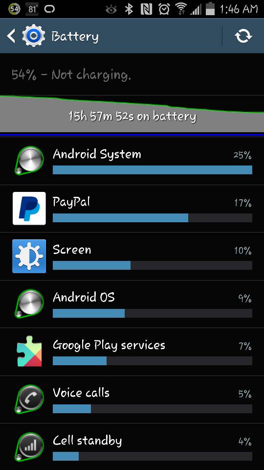

My battery used to last 24+ hours. Now I am getting 12-13 hours at most. Android system is always the highest, even did a factory reset the other night to see if it fixed the issue and it hasnt. :(
I think im doing very well compared to other devices. If i allowed it to get in the red I'd make it a full day im sure.
