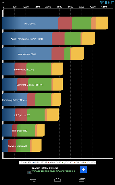

CM10, overclocked to 1.6 in performance mode.
Some higher, some lower, won't be terribly different. I'm using a custom kernel that's overclocked so it may run higher than others on stock.

Extremely stable, but not very cool (gets quite warm at that speed). Also, if you're using it AND charging it, it won't discharge, but it won't charge, either..
(With the linaro optimized cm10 build (cookies & cream, which I didn't care for, at all), it consistently quads 6200+ @ 1.6GHz. The GPU OC really improves overall performance, and is the only thing that stays OC'd. Even @ 1.3GHz w/SIO+interactive, it sticks between 5300 - 5500)

Out of the box, comes in *just* under the One-X, with 4.1.1, *just* over it. The real performance boost seems to come from remounting /data.. I/O throughput easily quadruples

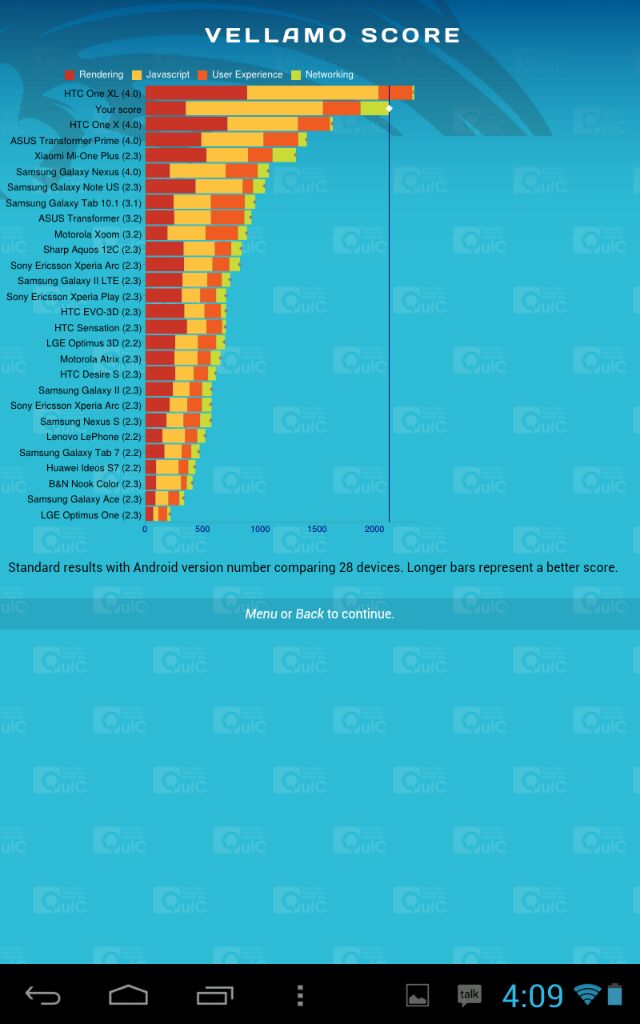

Here's mine, actually is different from the first ones posted. My bad sorry!
I am running Build number JRO03D
