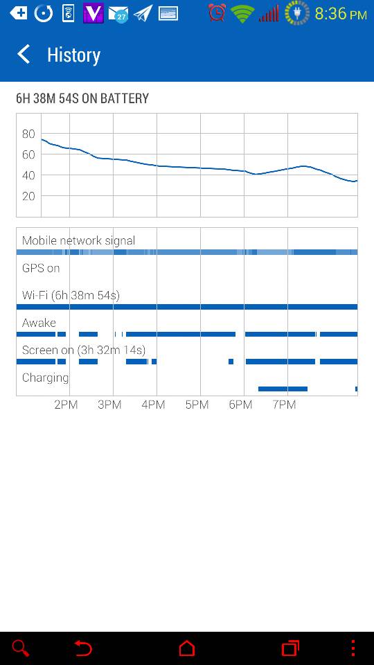

Here's how I'd make the first approach -
You want a monitor that can show power vs time, with separations for screen on and awake conditions.
You may have one built in to your phone under main settings, power, history or the like.
It'll look something like this if you have it built-in -

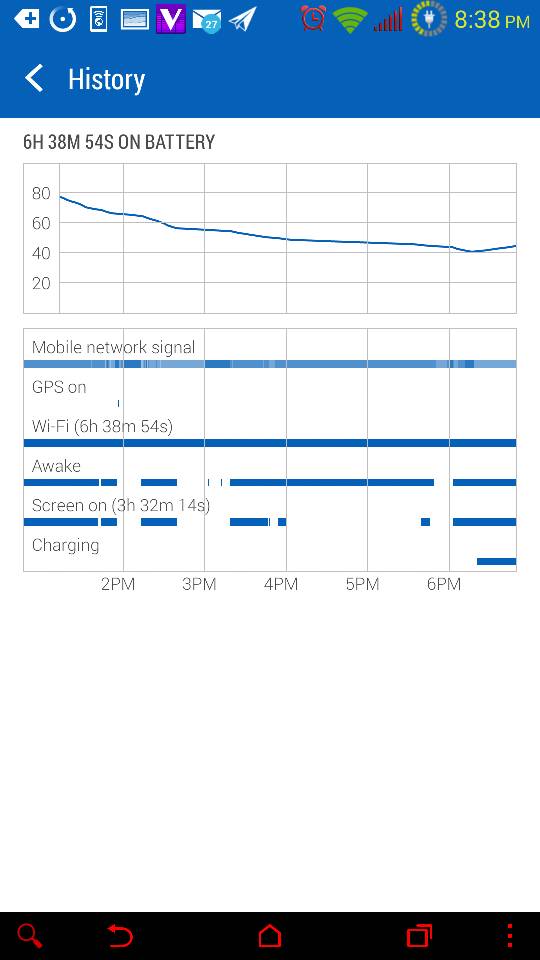

Here's a zoomed view so we can begin discussing cases -
Notice around 3 this afternoon, my screen was off, the phone was only intermittently awake to service my syncing schedule and power draw was minimal.
From 4 to 6 pm my screen was off but my phone was awake and power was being eaten right up.
That's when I was watching the Great Escape on Netflix through my Chromecast - the Netflix app sucks so I can expect that behavior. I can plug in whenever I want so I don't care.
Had that same trending happened around 3 when my screen was off and not using an app like Netflix, that would have been FAR from ok.
So, without using Greenify either, set aside a time to get a graph kind of like like that.
Best would be an hour of screen on doing what you do, followed by an hour of screen off where you'd expect it to do nothing - and see if it's staying awake when it ought not.
If your phone doesn't have a graphic like that available, GSam Battery Monitor has one.
You can use GSam or System Panel to check and drill into process details. From the thread you know that System Panel may be better for that part.
But if you haven't already, start there - get a graphical view of the basic hibernation performance first. I go that way because a picture is worth a thousand words.
