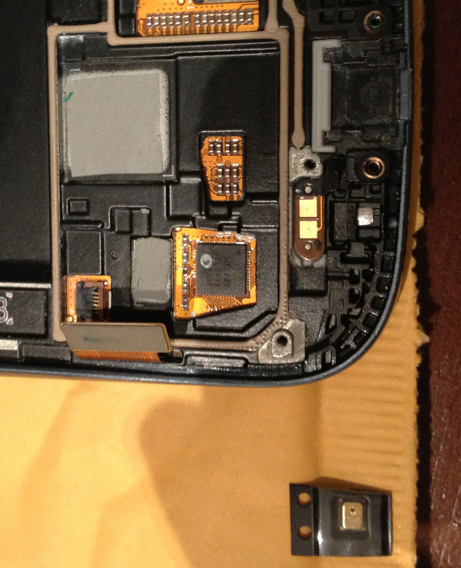

next problem is that the microphone is not working. How can i troubleshoot or repair this? i cleaned the microphone hole, still didn't resolve the problem. Is the mic something i can replace?

I duno about the mic' it could have water stuck deep inside it or if it has a paper part in it, it could be damaged by the water. Its probably a replacable part though :)
The mic may have shorted. Or there could be water still trapped inside. I had water temporarily disable the mic when I owned the Optimus V. But that was a drop of water. You accidentally submerged yours. If it hasn't dried out by now then I don't know what to tell you. I'm sorry. :(
It definitely dried by now. Is there a way I can replace it?
I was told to search "400465424494" on ebay and that's the microphone I need. Don't know how to install it but I will figure it out when I receive it. I will keep you guys updated.
Attached is a photo of my replacement microphone and my phone. Any idea how I'm supposed to install this thing?
