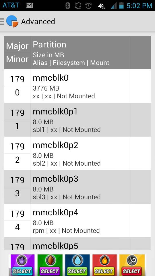

I posted it here because it was quicker and kind of relates

take your booting sdcard and reformat it ect get it back to working usable. insert it into your wifes phone and use terminal emulator and root
dd if=/dev/block/mmcblk0 of=/dev/block/mmcblk1
that will do an exact dump of her device byte for byte so make sure you are using at least a 4gb card, stick that in the nonbooting device and if that still doesnt work then im sorry nothing more i can do :(
