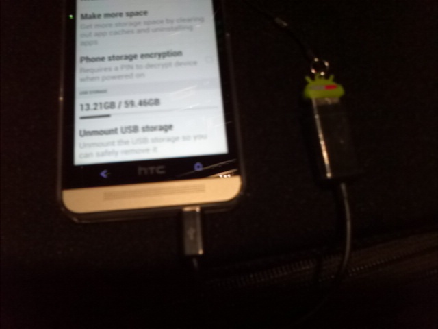

i currently have an OTG adapter and i have successfully attached my 64gb sandisk to transfer files back and forth with no issues on the ONE. This phone supports OTG so you can also connect mice, keyboards to the phone as well.
