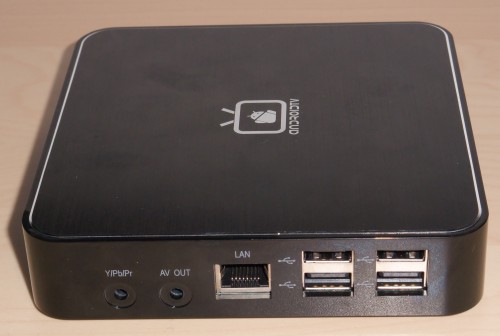

I bought some of the Rockchip boxes, too. It was described as the 3x USB version, but now I received this box with 4x USB.

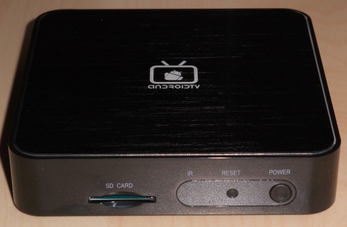

I tried to connect the box to my PC, but I wasn't able to do that. I did the following steps:
-Android TV Box is off, AC adaptor plugged in
-Connected PC and TV Box with a USB cable
-Press the reset button, then press the power button while still holding reset button
=> Here no progress is visible (status LED not active, Windows 7 doesn't recognize any hardware, Box will do nothing), until I release the reset button. Then the box starts ordinary.
The rest of the box works fine. But I must have root access, due I don't connect the box to a television, but to a stereo receiver (which has no display). Having no display for my GUI I want to control the box via VNC from my Computer (droic VNC server App).
Please help me to get this Box connected to my PC to update firmware to root access. Or is there any other way to do this without USB connection?

I tried to do these steps. But when I come to step 3, it fails. Holding the reset button and then touching the power button it will result in nothing. Nothing happens, until I release the reset button. Then Android will start ordinary, no upgrade process is starting.
How to start the upgrade with my Box? There has to be a way to do a firmware upgrade.
