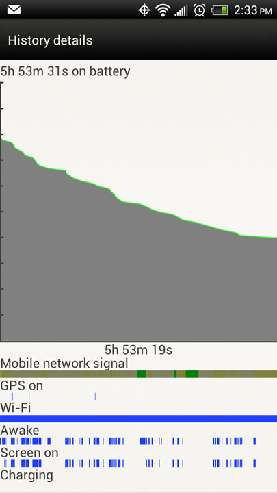

Ok... any clues below?.. looks norm to me THX

Something's not 100% there, in my opinion. Look at the second (detail) graph and compare to one I made while stress testing the other day -
Note that when my screen is off, the phone goes to sleep and the power curve shows that consumption stops. (ignore the short gap shown, that was a short maintenance / reboot period)
Now - look at yours, we can note a few things.
First, sometimes you get the right behavior and it flatlines when screen off/not awake.
But if I look at the period going from about 65 to 80% of the time shown, you should be flat-lining and instead you're dropping power. And within that interval is a pretty solid green block saying that it couldn't get a signal.
And, you're dropping power like a rock for the stuff you're doing.
So - given nothing's keeping it awake and that you're just not really doing anything, I'm going to go out on a limb and suggest that that looks like a reception problem.
To see if that's true, try Open Signal Maps, free in the Store.
Use the Maps on it to see if your phone is constantly hopping between towers or something and/or the graph to see if your signal is rollercoastering up and down severely what.
I also wonder if you're in a town where they're already working the Network Vision build out with new infrastructure and towers. Don't know if it's possible, just spit-balling here, but I wonder if some tower is starting to put out an LTE test signal and something's gone wonky.
Anyway - from those graphs, I'd say looking at the radios has to come next.
Note that when my screen is off, the phone goes to sleep and the power curve shows that consumption stops. (ignore the short gap shown, that was a reboot)
By the way, also OK to update PRL then Profile in that order about halfway through your Open Signals Maps viewing to see if it was just config thing that you could fix or not. But get some Open Signal Maps results before trying that, so you can tell immediately if it made no difference.
