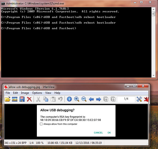

I am having a bit of trouble with the "adb reboot bootloader" cmd. See the screen capture picture bellow. When I hit enter the ZTE tablet reboots. But it reboots into normal mode then the "allow USB debugging" screen bellow pops up. I press "ok" and that's it. Nothing else happens after that. Am I doing something wrong?

Well I finely figured out the syntax of the cmd structure for this tablet. I now have the tablet talking to my laptop in the bootloader mode. If I tryed to download the wrong img file and flash it to the tablet. The tablet just sat there and did nothing. Now the tablet will flash on it's screen after reading the img. That the img has the wrong keys and so on and reject the img . The correct sequence for this tablet is, in recovery mode choose "apply update from ADB". Then in Windows terminal type "adb sideload <and the file name>". It has to be SIDELOAD not DOWNLOAD, that's the key to the cmd sequence in this tablet. And "adb reboot bootloader" does nothing. The reboot bootloader has to be done by power button + volume down button. At lease now I made some progress on this tablet after 4 days work. A good in It is a good inside project on these cold snowing days. Now I just need to find the right recovery-CWM image file for this tablet.
If you are in stock recovery, it will not allow you to flash anything that doesn't have ZTE signing keys. Period. That's where flashing a recovery via Fastboot came in, to bypass needing Root. ..FYI. Now, KR just released v5.0.1 , maybe try it out
