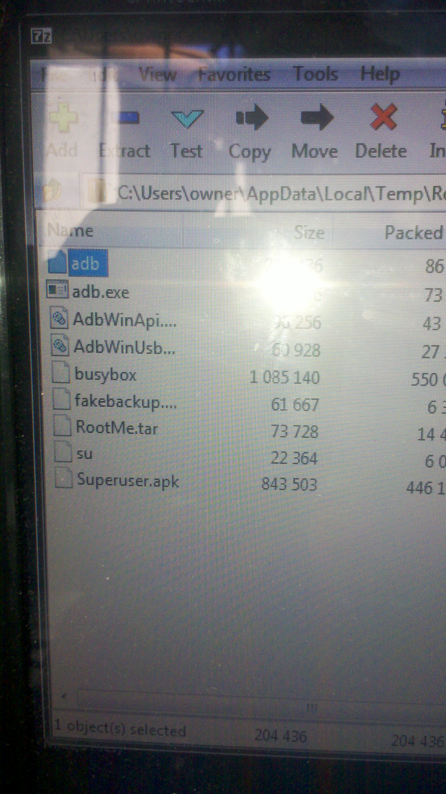

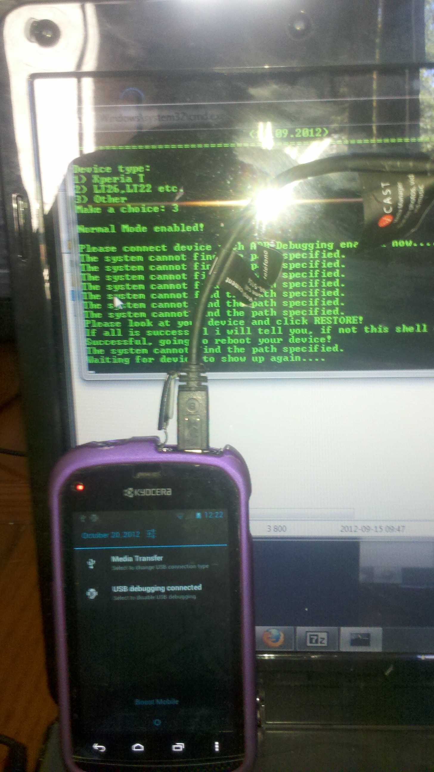

:confused:Yes Hello Weis whatever u said makes no sense , can u explain? Here is what I am having trouble with and I even took pics to show every1 what is happening on my end.1st off I don't understand downloading busybox when if u look it is already in the root bat file w/ the su? Next I redownloaded the drivers again for ky hydro boost mobile. All installed put in same folder as root.Ran root bat selected number 3 as ive done everytime w/ the phone in debugging and transfer. Runs bat then says rooted but i know im not cause su is not in there, u dont even need root checker the su willappear in app drawer.not there.I dont know ?Anyways if u know something secret lemme know cause I want root. thx
Ptree;)

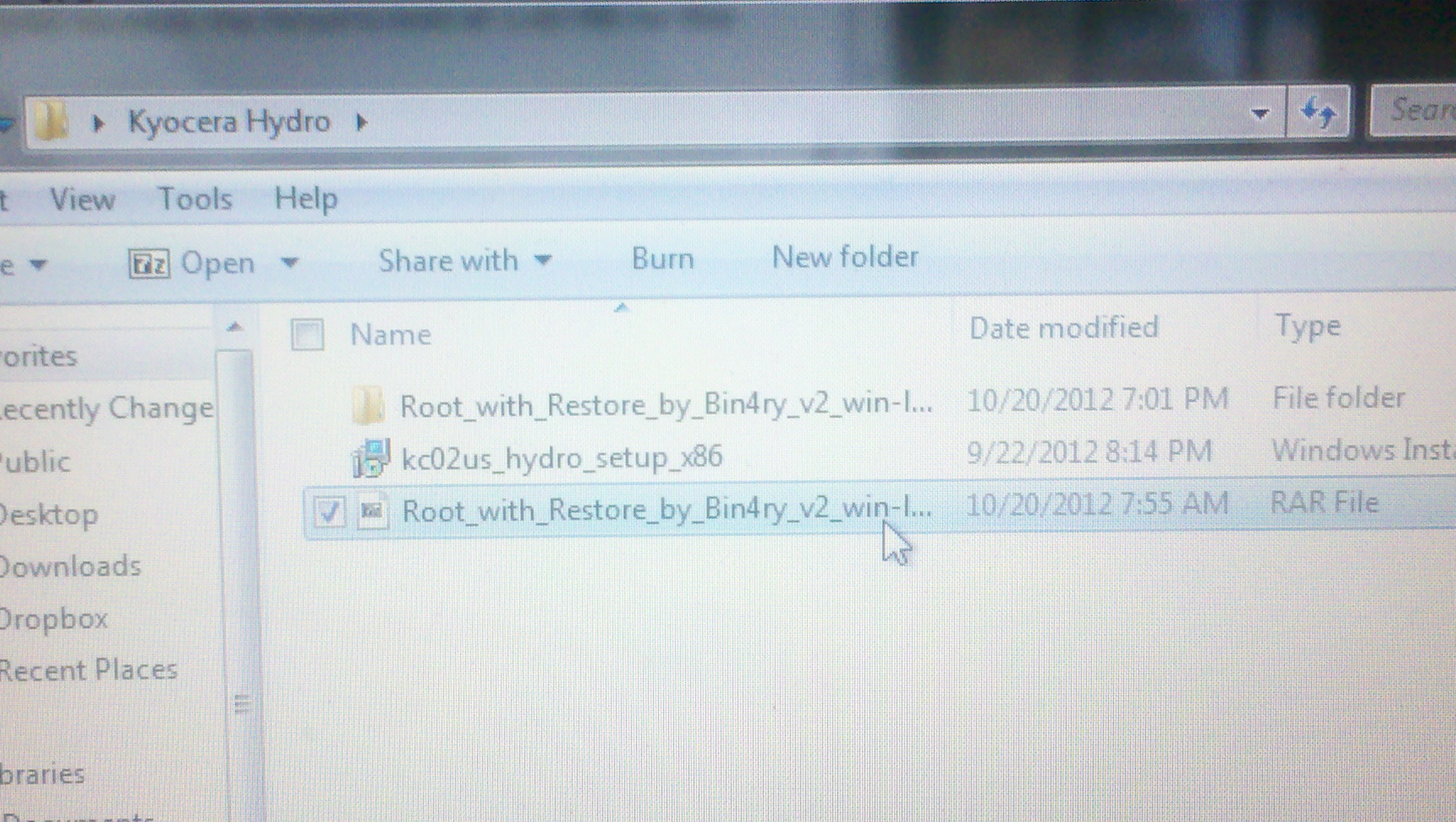

Here are the files I found in root file and the drivers I downloaded!

i had the same prob where nothing would happen on the phone when the bat file runs. had to use a diff usb port and let the pc install the phones drivers again. good luck
It looks as if you are running the bat file.from inside the zip?
If so.you must extract it to a.permanant folder.
You have file.path errors.going on there.
:D:smokingsomb: Yes hello, ok special thx to Wiesshund ! Sooo apparentley I could have been rooted this whole time, but had never physically had to extract a rooting file in 7zip before( droid 2, galaxy2 and htc t bolt were all one click.This time the file needed to be extracted in 7zip because it was not open that was the path error I kept getting on c prompt. So basically that was whole problem! I then ran program then plugged in phone when c prompt asked. So again thx to everyone but especially Wiesshund!
