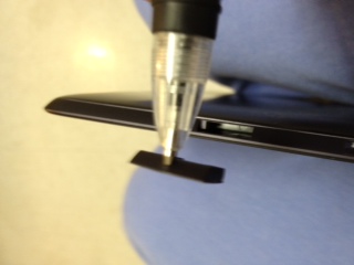

I do not have my dock yet but I did remove the plugs on mine just to see. There is a hole in the plug. I stuck the tip of an ink pen into the hole and popped them out. Do not stick the pen straight down into the plug but from the back of the prime towards the front. When you lift there is a little edge on the hole that the tip will grab and they will come out.
I would save them.
I would save them.
Yep, I got them. Thanks. ;) I think mine were much harder to get out since I did, in fact, try to dock without taking them out (not sure what I was thinking but I was following the directions!!). Anyway, its working well now. ;)
