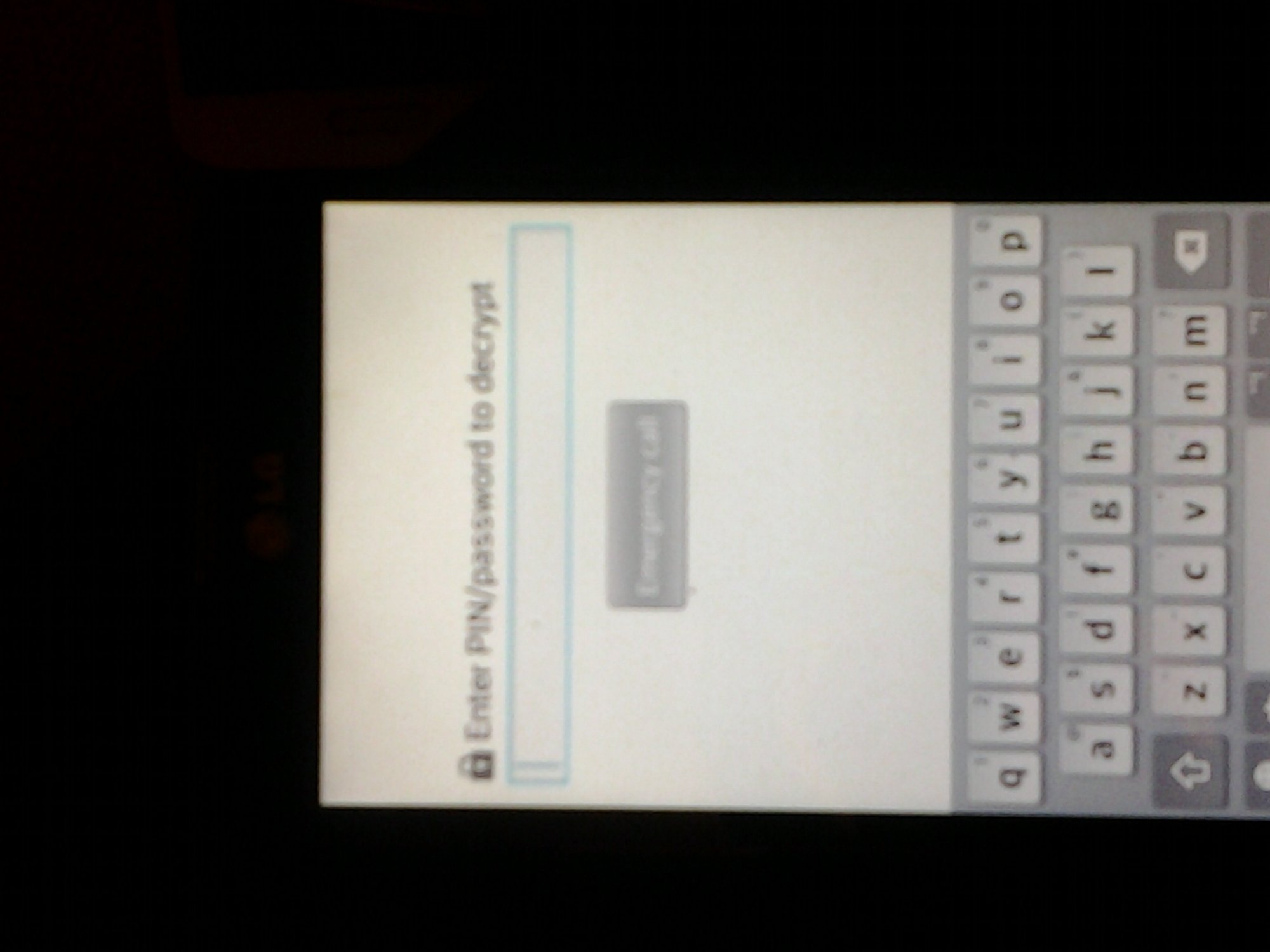

i did try that and download mode restored. sadly now i get when i power on. i know as fact that wheni bought it it wasnt encrypted, also that i didnt encrypt it. i was reading about possible reasons and near as i can figure its a problem with 1 or more partitions.
Reflash stock from download mode from the flash tool again. (it will get rid of the extra partition since it wipes /system and resets the partition table)

Then guess you have no choice than to send it to MetroPCS. Just say that it got randomly encripted. The warrienty will probably not be voided since your bootloader is relocked. It's a little cheaty. But since you have stock and download mode. They won't suspect a thing.
(All phones have a 1yr warranty even without service but only if it malfunctions)
Just say it malfunctioned :p you'll get your money back or get a new L70.
