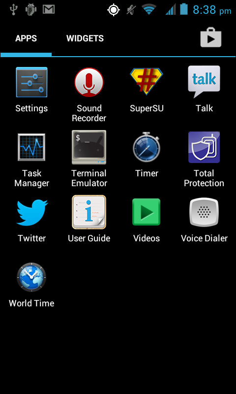

No. I'm not doing that, i didn't know.
so whats the path i should use?
ADB is part of the SDK bundle that is installed on your computer.
When you installed the SDK, do you remember the file path you installed it to?
You said you were using the ADB method. (with a computer)
I see you have Terminal Emulator on your device.
Are you perhaps using Terminal Emulator? (no need for a computer) or the ADB method? (using a computer)

I was trying to do this using the terminal emulator but nothing happens, thats why I'm trying now this way, but i didn't know about the Sdk, I'm installing it right now and then i tell you what happen.
Well, terminal emulator is simpler and should work.
Perhaps the commands you typed in were incorrect and that is why it did not work.
Try typing this in after you type the "su" in terminal emulator (no need to type "adb shell" in terminal emulator app)
(After typing "su" in terminal emulator, the $ sign should turn into a # sign.)
Code:
dd if=/sdcard/recovery.img of=/dev/block/platform/msm_sdcc.1/by-name/recovery
then hit enter.
when prompt returns
type reboot recovery
hit enter
Phone will reboot into recovery mode
Ok i finally did it, i have the recovery installed, i couldn't do the computer way so i follow the directions on this video (not sure if we can post external links , if so, delete it)
, so i installed android sdk and i did what you said but the cmd won't work so in the video the guy gives a folder and you can open the Cmd from there if you watch the video you'll kwow what I'm talking about, and then i did everything but when i type the command:
dd if=/sdcard/recovery.img of=/dev/block/platform/msm_sdcc.1/by-name/recovery, it says acces is denied, so i think it was the right command the one you gave me just excactly how you wrote it,so as it was the correct one i used the terminal on the phone and copied the command that you gave me and ta tan! maybe i was writing wrong the command, Thank you soooooooooooo much. you really helped me, you have no idea how i feel now!! xD
