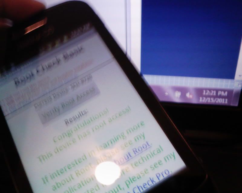

Android market worked! Thank you GTK313
I found something out. I did the one click root access on my phone again, LEt the app update the stuff (superuser,ect) and I updated Root Check basic and it worked!
http://i103.photobucket.com/albums/m131/jawsh1234/MYLO0699.jpg
jawsh1234
