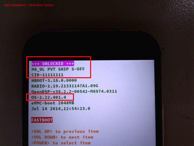

Hi Your warranty will still be fine unless you have burnt out the cpu or some such thing connected with overclocking ETC. Even then they have to prove it was that which caused the fault. This is for all EU countries FULL ARTICLE HERE
I sent mine in with a touch screen fault dead band across the middle they said no warranty repair and sent me a photo back. Attached with the full root job showing Super cid the lot I sent the phone like that to test and i got a new phone. So i am not saying your warranty is fully covered but your whole warranty is not voided. Its a myth they want you to believe.
