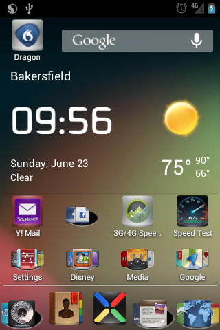

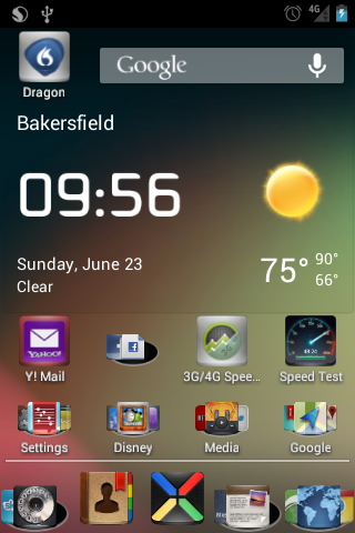

I believe this is what you want.
Here is my View attachment 56544. Just copy to your phone with root explorer, set permissions and reboot. The only thing is that it will not work if you change themes.
The problem with this is that when you really are on 1x, it will say 4G. This is why the devs do not switch icons.

The reason CM says 1x when on 4G is not an icon problem. Its a source problem that still needs to be fixed.
