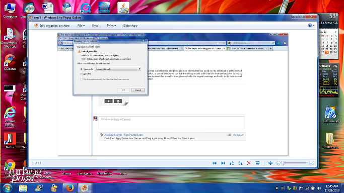

I am still in no root hell. I am using the HTcdev site and step 9, right where I get the unlock code comes to my gmail. I go to save it and it will only let me save it as a media file. The format that the unlock code bin gets saved at is in either notepad, WORD or even a media file. Maybe I need to change my default programs that my downloads use ? Whatever format the unlock code gets saved as, media file, notepad, WORD is not being read when I run the flashboot unlock CMD to unlock it.
the attachedment is what happends when I go to save the unlock code email.
when i get them i think msn saves them as an "attachement" wich has not been a prollem. the file is still "unlock_code.bin"
can you not right click on the attachement and "save as" so you can pick the destination and file type?

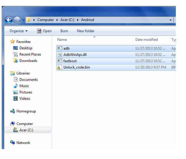

These are the 4 items that are in my C/Android folder from where I am trying to unlock the bootloader with this CMD -
fastboot flash unlocktoken Unlock_code.bin
Hopfully you can read the attachment
Do you have the phone in fastboot? If you're in hboot,the command won't work.
