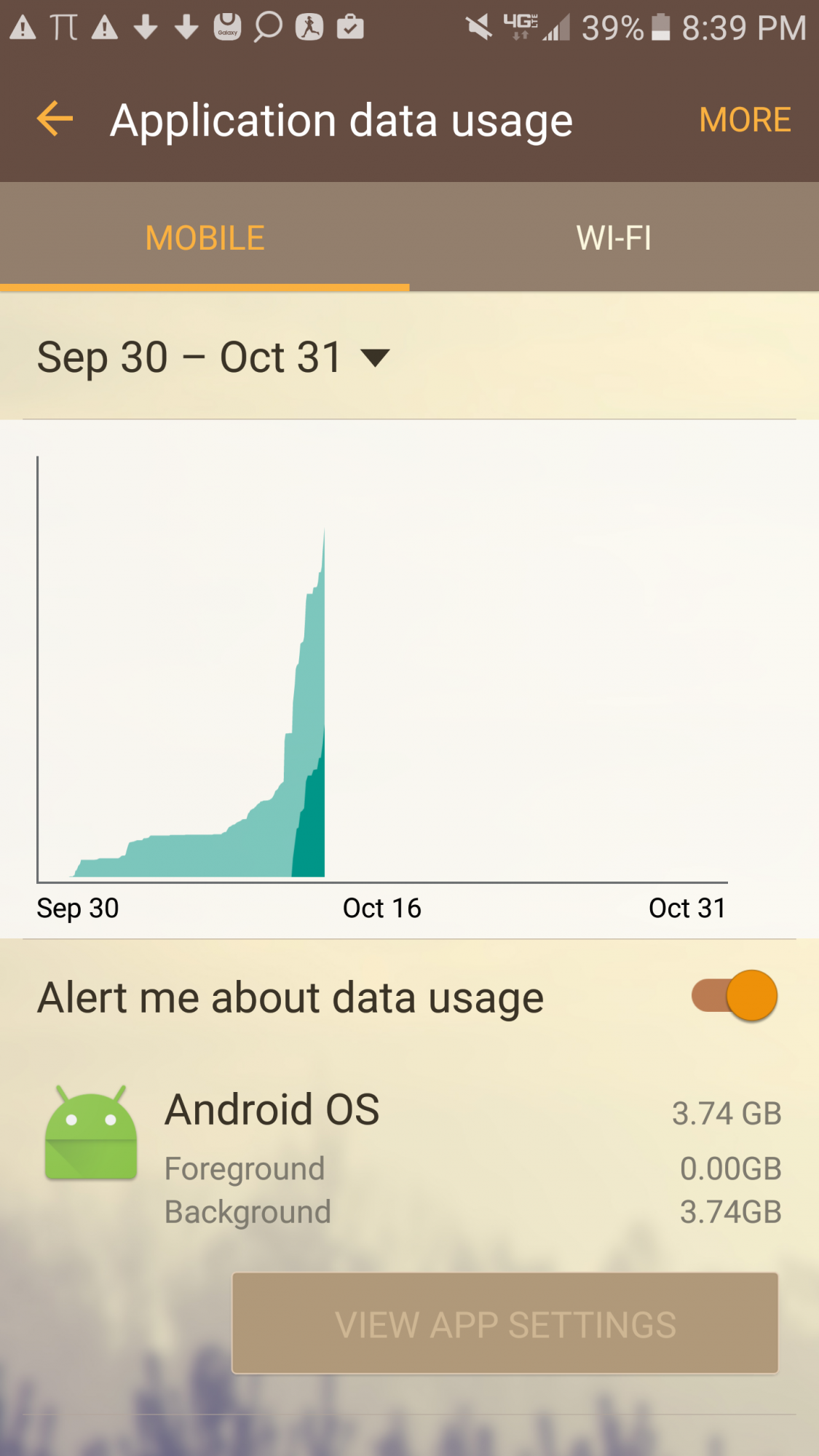

This problem has only started a couple days ago, when I got an alert that I passed my data limit, then 2 hours later that I had passed the 1 gigabyte extra limit. I'm on vacation so there's not much time to use WiFi. I have never had this problem before. I go into my settings and this is what I see. I have no clue what's going on and so far I'm out 40 bucks cause of going over the limit. This is insane, almost 4 gigabytes in 3 days, what the hell is happening? I've deleted numerous apps and the only thing that stops this is restricting background data.

Try going into the more menu from your screen shot. Look for a setting like "restrict background data".
Also, has your *phone* taken a recent update? Some times your *carrier* will push an update over a data connection.
Also makes sure the Playstore is set to update apps over WiFi only.
I've set restrict background data on and it does stop the OS from eating data. I was thinking it might be because it's downloading an update, last update was September 25.
You will lose some functionality with background restricted. Things like location, SMS/MMS, and time settings. Google Play Services does not like being restricted.
This is a temporary fix. You can try to toggle it on after a bit to see if it is still acting up.
Also, if it's an update it's the biggest I've seen.
Like Chan Chan suggested see if your devices backup is running and you should have Sync Off when not on a WiFi connection.
This is insane. 4.54 gigabytes, looks like restricting background data doesn't help. I turned off sync and I'll see if that was the culprit.
If you want you can switch on airplane mode. This will shut off everything. You can turn WiFi back on for internet if it's available. Then maybe turn airplane mode off occasionally to check messages and such.

Airplane mode time. Your probably going to need to do the factory reset. Or flash factory firmware. I don't even know what phone you have or Carrier, Android version.......
Already did the reset and no luck, looks like it eats data up at a rate of 10mb a minute. I have the S7 with Verizon. Even when on WiFi it continues to eat memory (doesn't really matter on WiFi) but taking into account WiFi usage it whatever it is has used about 15 gigabytes of data. What the hell could be that big?
Pikek, it was pikek. I deleted it and switched it to the normal kik messenger and all the data eating seems to have stopped. No clue why this happened, maybe it was some kind of effort by the official Kik people to get people away from pikek. Will report back if anything else happens but it looks like it's fixed. Thanks for your help I really do appreciate it.

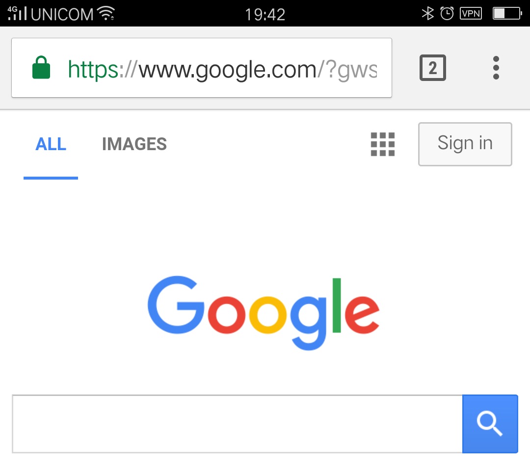

Google is blocked by the government here, and UNICOM is a Chinese carrier.
BTW I can't read German nor Korean, so never look at those. I'm English and Chinese only.
