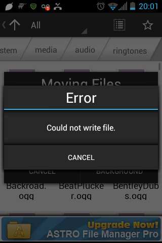

Do the ringtones need to be ogg files, under a certain length, a certain sample bit rate??
Plus I can't copy to that folder Weishund:

you do need to be rooted and set your file manager to read/write to root folders, but i can put mp3 or ogg ringtones into the media folder and set them to work on restart
hmm, mine is rooted. I don't see how or where to set my Astro File manager to read/write to root folders?

i have ES File explorer but i don't remember where exactly the root setting is in it,but i know its there.

I believe with es you have hit the,menu button to got the option to change r/w permissions

To set es to read write access in ES you need to go to menu > settings > root settings > and check root explorer, up to root, mount file system, and backup system app.
make sure you know what you are doing when you are using root in a file explorer!!! use EXTREME caution! you can an will brick your device if you delete the wrong file or folder.
