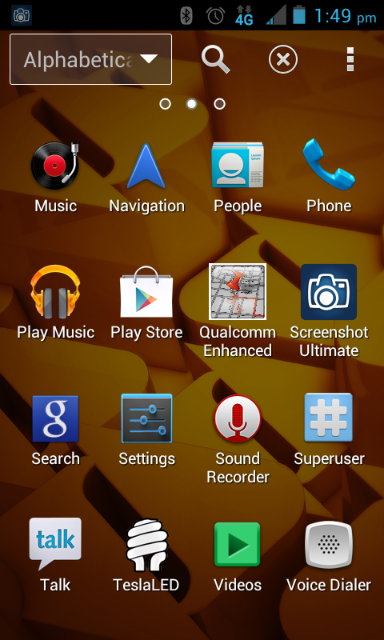

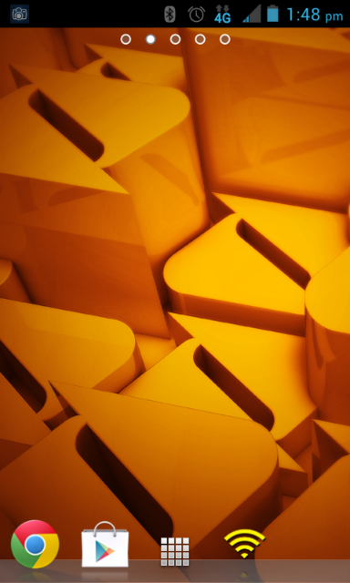

Flashed 0.2 beta. Liking it so far. Still having the same problem with connections optimizer. Here's a few screen shots...
EDIT: I see you removed the connections optimizer from the phone. Tethering works but connections optimizer is still showing up in the system settings menu. I guess it force closes cuz it doesnt open anything when you select it. Love the rom so far.

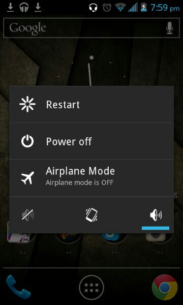

Can add a "Reboot To Recovery" option to this menu? [Don't know the name of the menu lol]

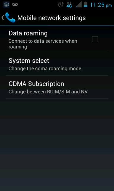

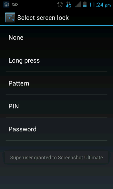

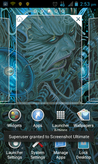

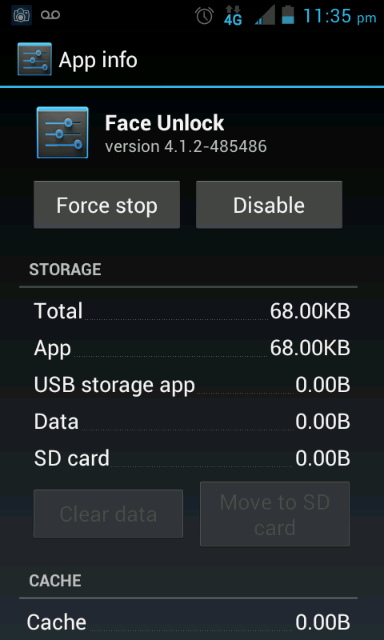

Flashed 0.2.1 boot animation worked. Booted up in less than 2 minutes. Face unlock is not showing up in the lock screen settings. It says its installed in the app manager. Phone menu doesnt let you choose between cdma and lte (3g 4g) but there is an app to get you to the hidden phone settings menu. Heres a couple screen shots.
