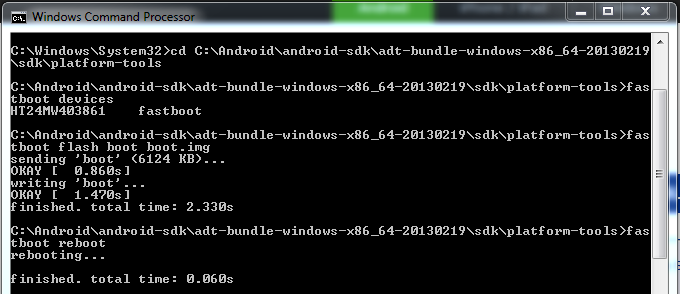

Flashed viper last night, got stuck on splash screen with this build is for development puposes only. It worked so well the first time that I even tried again and got the same result. I read lots of forums about installing "Flashing" a rom. I read the instructions for flashing viper, multiple times. still no work.

I followed viper instructions, but I also installed boot.img with fastboot as well. I would like some input but I also realize people need days off. So I will just continue slowly and carefully until the people who are un afraid to answer forums come back
It sounds like you needed to "fastboot flash boot boot.img" to flash the kernel. You said you did that, but it is usually the cause when stuck on the splash screen. What recovery are you using (and what version # of it)? Are you S-on still, or did you go ahead and S-off?

Yes I did 'fastboot flash boot boot.img'
I also as suggested by viper FAQ did 'fastboot erase cache' before the boot.img flash.
I am on TWRP v 2.4.4.0. *** Flashed over the top of CWM , because didnt know any better and I read a post that said cwm is not good with one-s****

I attached a screen shot of flash commands I ran last night.

That shouldn't matter for anything while flashing a ROM. You just boot into recovery, wipe system/data/cache/recovery, flash the ROM, fastboot flash the boot.img and reboot. For AOSP (cm10.1 and the like) you would most likely need to flash gapps as well.
