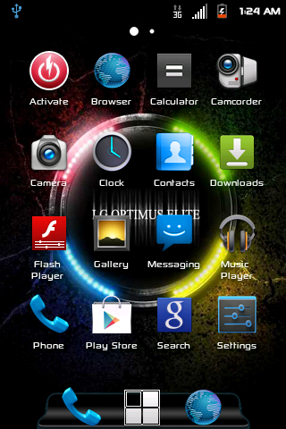

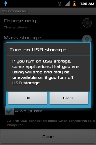

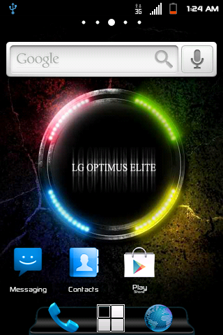

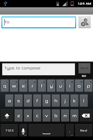

just noticed that the status bar has lost its ICS coloring for the clock and it would appear so has the 3G icons and signal bars. did drop down menus and phone theme properly?
edit: I think I know why the coloring,etc isn't there. I'll check it and upload a fix for it in a day or so. still ok to use until then.
edit 2: temp fix is to flash this theme right after installing ROM then reboot. everything should be properly themed. http://androidforums.com/elite-all-things-root/623326-ics-elite-theme-harmonia.html
From seeing the ICS theme that you made, the drop down menu and some other stuff were not themed. But, themeing of messaging, browser, and the dialer look awesome!
Things that need to be fixed:
Notification dropdown
3g and signal icons
That's all I saw wrong, I'm pretty sure Hashtag pointed out some more in his screenshots. I wont post the link because this still needs a little work.
Great job Curtis, keep at it :D
I overlooked my systemui.apk of all things. all anyone has to do to get the full effect of the theming is to flash my theme above right after flashing the ROM,then reboot. it will restore proper systemui.apk. I'll upload an update with some other things done in a few days.
