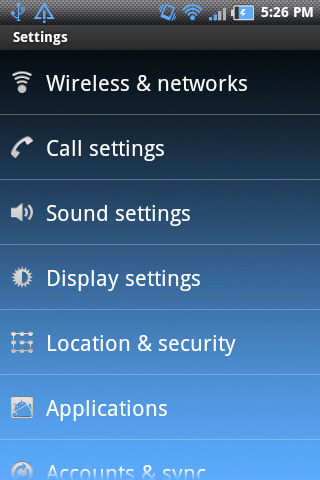

well i got it to work using root explorer. i just replaced systemui with the themed one i made then checked all the boxes under permissions rebooted and viola. fully themed stock++ lol wish it would just work through cwm

no not yet im still finishing it up here are a couple screenshots of what i have so far. its basically my carbon theme that i never posted because the new roms that have come out.
