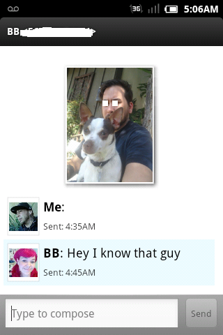

MMS and Roaming indicator fix
metropcs MMS send apn.xml

im able to use the installed camera, take pictures, and saves them to the gallery.
messaging is old GB stock style, due to the mms fix.(or unless bo replaced the miui mms.apk with the stock)
