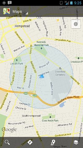

GPS works .....
GPS works .....
Maps does the same thing for me without working GPS when it's using wifi/cell tower location. That big bubble around your marker is the degree of uncertainty - it's not accurate at all. A real test would be to go into navigation and see if it works there.
your right it only picks up gps by a tower :(
