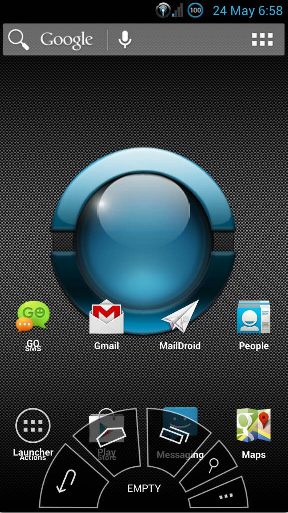

Just flashed 15 minutes ago for the first time. Already had 3 reboots. I have a nav bar showing at the bottom of my screen. How do I get rid of it?
Anyone know how to get rid of this little navigation ring thing that appears whenever I touch something at the bottom of my screen? I checked the navigation ring settings but that's not it

that one is under Rom Control.....i still cant find the Navigation bar size...
i misread it. fixed oh ya
Like I said, I checked the navigation ring settings. That doesn't affect the thing shown in my screen shot. I just want to turn the thing off. It's annoying.
