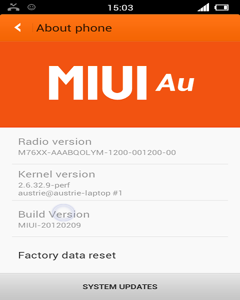

Even though i'm using the Ideos X6 port as a base, im still trying to fix the Desire S port.
I figured out the reason why the Ideos X6 port gives us cell signal; it makes the phone think it's network type is GSM. Now i tried this finding on the desire s port, and it gaves us signal, but with the Desire S port the signal is completely stable. Though this finding is only a temp-solution to getting cell signal because we're supposed to be a CDMA phone. I'm waiting for zukriaksah to come on so I can talk to him, this would be better with a coder like yumbrad...

Here's a screenshot of the Desire S port's 'About Phone' with cell signal...

I figured out the reason why the Ideos X6 port gives us cell signal; it makes the phone think it's network type is GSM. Now i tried this finding on the desire s port, and it gaves us signal, but with the Desire S port the signal is completely stable. Though the finding is only a temp-solution to getting cell signal because we're supposed to be a CDMA phone. I'm waiting for zukriaksah to come on so I can talk to him, this would be better with a coder like yumbrad...
What's wrong with our phone thinking its GSM? :p
We're not a GSM phone so it doesn't feel right me lol, and also it might be preventing data.
