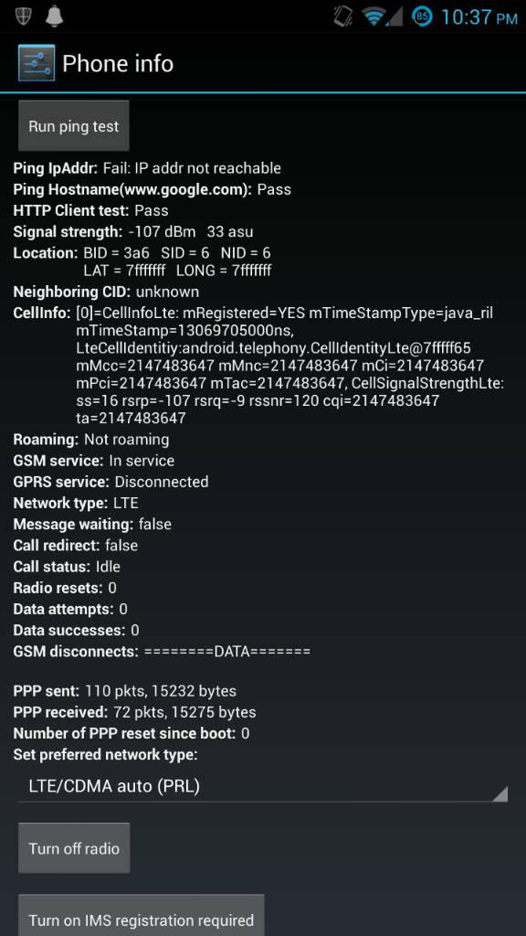

idk if it's just me but the signal drops pretty frequently. even the battery menu shows blank spikes in cell signal. wanted to check.

Agreed.my signal on cm10.1 is a lot weaker than aokp.
