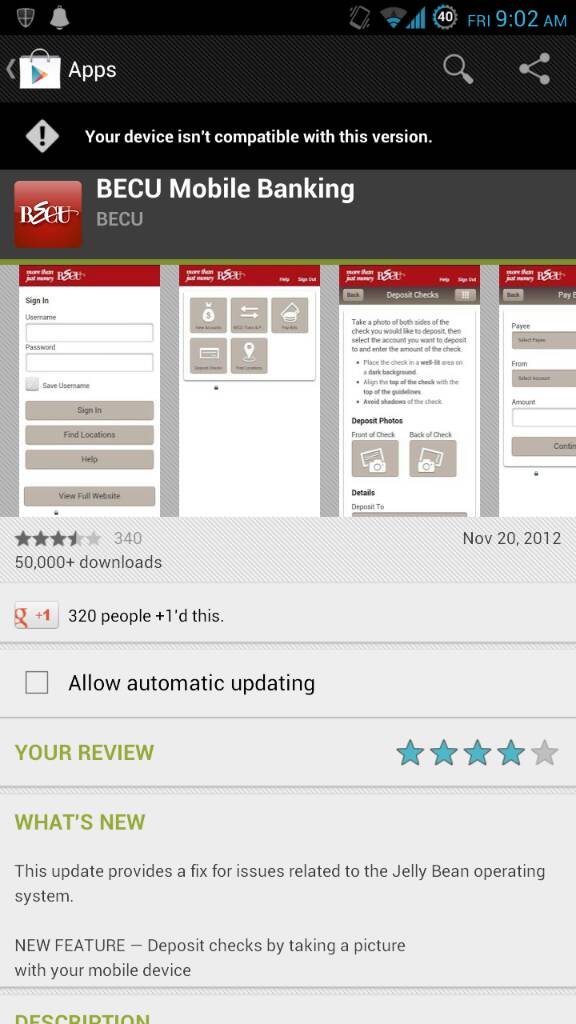

Yes. Try to get them and I get this message. Ironically, this app is currently installed when I see this:

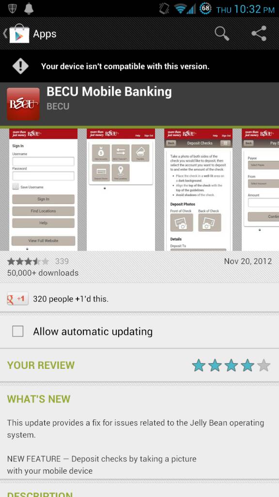

Just checked, mine does not say that. I'm on a nitro, running aokp41 rc4 with dpi=280.
If you have changed your dpi, you might want to go through the dpi steps again. Otherwise, I guess I'll try to remember to check the spectrum tomorrow.

I changed my dpi, but I did the same on cm10 and cm10.1 but didn't encounter this.
I wiped data, but still have the error:
I don't know what default prop is. I used the aokp rom control to change the dpi. That might be the issue... I guess it depends on how that rom control app alters settings.
Yes aokp rom control modifies build.prop. Go through the steps there that tell you how to fix app compatibility issues. Your default dpi is 320.
That did the trick.
