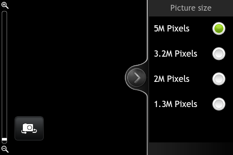

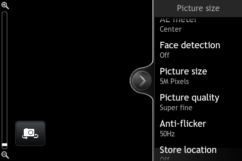

This ROM is ported by DROIDPM for Spice MI-350... I have done the required tweaks and made it work on MICROMAX A75.... i have used it for 3 full days without any issues, i mean without even a SINGLE issue. best part is just flash the data2ext zip and u r on your way to 1gb internal memory.
Pleae note that it's a Sense themed ROM so UI is unlike ICS but going by my experience it's the most stable ROM for our MMX A75.... Camera is 5MP but the clarity is much better than the stock MMX a75... front and back cameras work without any issues... 2G, 3G and WIFI both work faster than other ROMS with better signal strength... Thanks a Lot DROIDPM for this wonderful ROM.

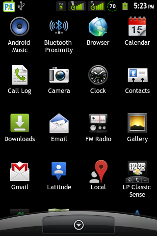

HTC Sense themed, Sense Launcher, Sense clock & weather and Sense Widgets
