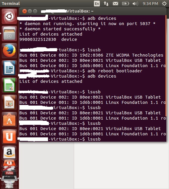

It doesnt even get detected on PC to run fastboot or any of its command..
I tried on both linux and PC.. bootloader mode is all weird here..
but if someone else can check it out would be great. I might have bricked bootloader.
Only way for us is FTM mode..

Thank you for your response. I have to ask though...did you get the fastboot drivers setup properly in windows? They are frequently a huge pain to deal with. In Linux did you get the udev rules setup for fastboot?
Drivers come into picture when it get detected, there is no detection of device either on windows or in linux in bootloader mode. . and udev is setup properly. and adb works fine..
even lsusb doesnt display it..
Just for reference i have attached screenshot. This is really strange for me too.

Thanks for the screenshot. You are correct that it is not recognizing it, but I notice you are using virtualbox. A great app indeed, but the drivers are all screwed up because your device is actually connected to windows and being virtualized. Additionally in windows, fastboot drivers for zte handsets usually need to be manually forced and will not be recognized until doing so.
Would you be willing to download my recovery installer for the warp2 and run a couple tests? It is a real linux environment, not virtual, so it is much more likely to work. If it doesn't work I will give up on the idea but i am still not convinced it won't work :)
