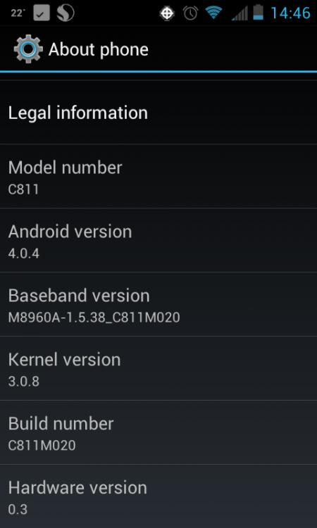

Currently I'm at 404 M020
Did you fix shutdown issue with ROM 412 from Doctoror? or any different recipe?
I see one bar signal strength of network on status bar :D. you are using system 4.0.4 build C811M020, I already used it and had some issues that you have. Since I change to M050_system from Doctoror no need to fix any thing...the shutdown issue disappeared :thumbup:
Yes, there is one bar on indicator but signal is good, it is just the bug in indication.
