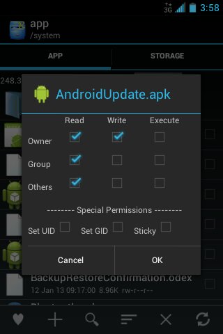

As for making a user app into a system app.
Using root browser or what not go to data/app and long press on the app you want and use cut not copy i found copy doesnt work then go to system/app and paste then make sure permissions are set to rw--r-- then reboot and it turns it into a system app and if you do a factory reset most apps dont work and will force close.
This is what permissions need to be set to.
For some reason I can't see the pick.

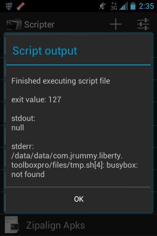

So dev said that the problem as to why I can't freeze or uninstall an app is because it sounded like my 'system is R/O'. Dev suggested that I go into Scripter (in RTBP) and to run the script "Mount System R/W".
If I do this it won't mess me up, right?
In root browser if you mount r/o as r/w in system it stays in r/w. but as far as i know i dont see any reason why it would do anything. Give me a minute and ill try it.
Hey, I tried and didn't do anything. I advised dev that that didn't work so I'm waiting to see what the response is.
After I did that I got something like this. Look at the line at the bottom where it says at the end something about busybox not being found. Maybe it's nothing
