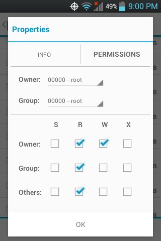

I'm using cm file manager, when I go into permissions or has four columns S R W and X, which do I check, any idea?
And 3 rows Owners Groups and Others
This is what it looks like
Never used that so go into romtoolbox and use the root browser in it or download root browser for free from g-play. I personally use root explorer not familiar with the one you're using.
Just saw the screen shot... that is correct. The columns stand for (R)ead, (W)rite, (X). execute. Don't worry about the first column on your file manager.

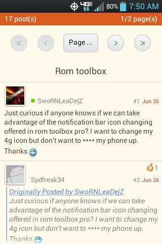

See, it actually looks good, matches the GPS icon. I like it ;)
