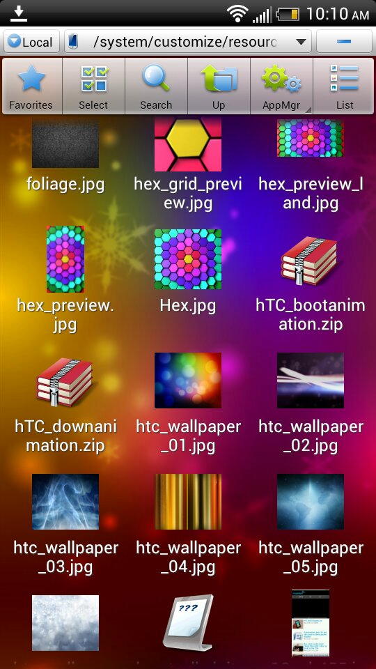

Take the HTC_bootanimation.zip and rename it to bootanimation.zip, the downanimation is for when you power the phone down. Then push it to wherever it is on Unlocked Potential. Set permissions. Reboot. Enjoy.
Rename the one from Unlock potential or from.the jmz stock rom

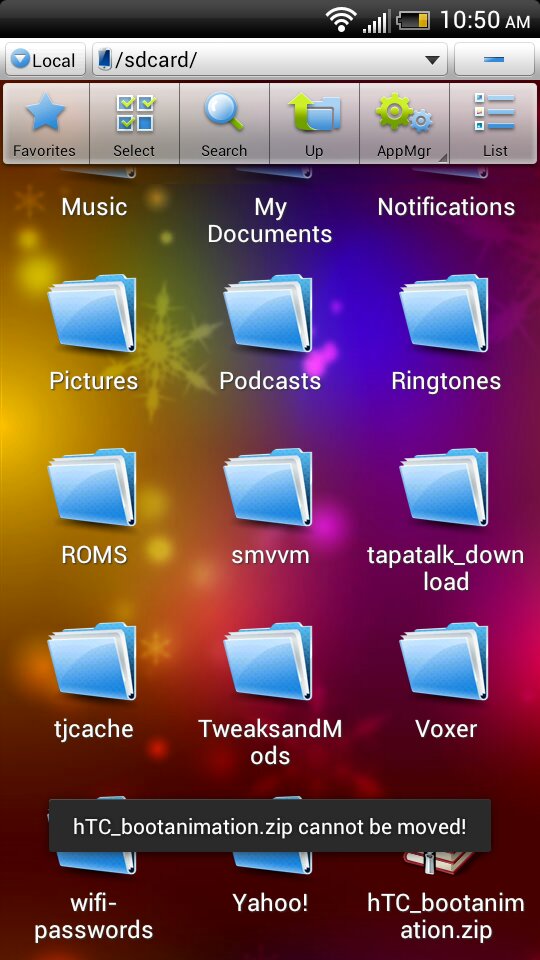

I just grab it from jmz and I can't move it were it was

jmz I think. Whats the one named in Unlocked Potential? bootanimation?
The one that name from Unlock potential is HTC_bootanimation is the same from jmz I already have the bootanimation from sd card now I need to move it but I can't
Okay under ES go to settings > Root settings > make sure that Mount File System is checked and that you have Root Explorer and Up To Root checked as well.
