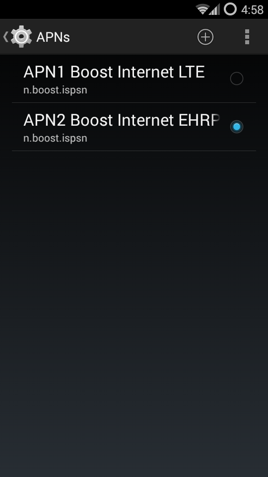

For those on Boost Mobile this does work.. (having flashed CM11 many are stuck w/ Virgin Mobile as the carrier label)
LTE shows that its on but no calls can be made, had to switch to 3G for calls but the battery saving doing so is not a problem. i flashed this fix on both a fresh CM install then v5 radio immediately right after and CM running for a few days on the v4 radio.. both times worked like a charm...
so i say it wouldn't hurt to try it out for yourself
I can confirm this works too!! I've been using 4g LTE with the zv5 radio since last night on my Boost Volt :) My mms sends pictures and texts perfectly now! Thanks a million for posting the fix @baconsauce
*edit: my GPS is working now too @whoshotjr2006

To answer your question.
1.yes
2.yes
3.yes
4.yes
side note, it will take 5 mins or so for lte to "wake up" and start working, make sure it is enabled in your notifications quick settings menu. =)

I've been working on the data issue, and now with a few added libs I can get ehrpd internet running on cm11 which is the precursor to lte. I think my test has lte working but where I live now just happens to be the tiny portion of town that doesn't have 4g. I'll upload a test soon if anyone wants to be a guinea pig for me and see if it works, so I can integrate it into the build process.
I tried adding those zips into the build process and wasn't having the same luck you guys are, but when I flashed them they worked. Dunno whats going on there.

That's what I did, didn't work when I built the contents of the zips in. I pulled all sorts of files from lib and etc last night from stock ROM and when I added them to the cm11 zip and flashed I got ehrpd, so gonna go that way for now.
I reinstalled this rom wit the apn fix zip and zv5 radio and i had lte initially, data, mms calls(in and out) worked, i turned on wifi and turned off and now all i get is 3g but everythang still works jus fine, idk if its jus a glitch or what but i thought id jus point that out, but other than that nonimportant issue i havent had any other issues wit this rom, great work!!
