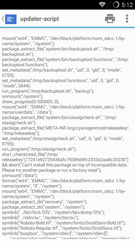

Weird, not sure why you got status 7, but try to open the zip, open updater-script and remove the top couple of lines about checking if the device is an x5 before install. That might be the problem.
Deleted the first 3 or 4 lines...started with deleting 2 then got status 6 then a couple more and it finally flashed. Here is what the updater script looks now

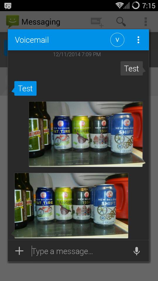

Stock messaging app won't send
Textra from store will send and receive sms and MMS
Videos and sound are still broken
Tested phone by calling a phone in my house...it went through but no sound on either end..also while phone was 'connected' screen started flashing and when I hung up the other phone, my volt rebooted.
